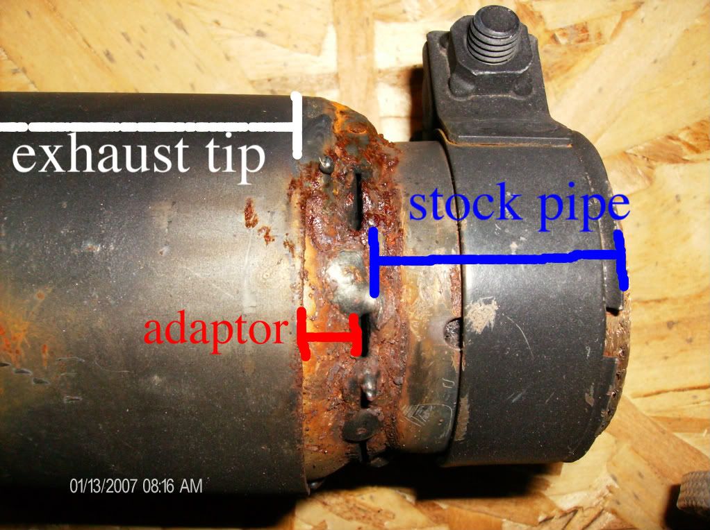

1. Cut the clamp off the stock "water heater".

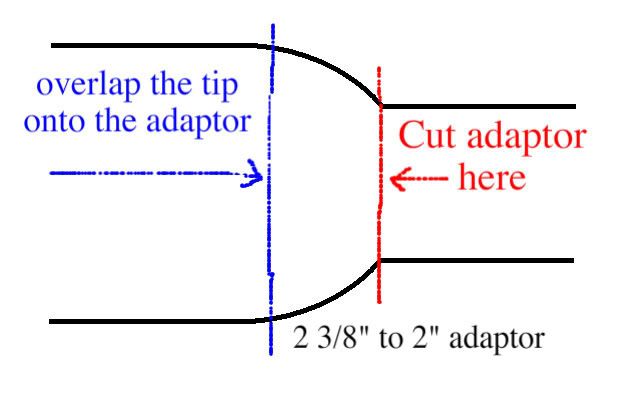

2. Get an exhaust adaptor at auto store- I can't remember what size adaptor (made up #'son theillustration) so once you cut the end off the "water heater" take that little piece with you to the store tofind the right size adaptor. I couldn't find an adaptor that would be small enough to match up to the size of the clamp off the water heater and yet be large enough to fit a 2.5" tip.I know my exhaust tip was like an 1/8" larger than the adaptor so was only able to weld about half way around but plenty strong.
3. Buy a 2.5" exhaust tip.I went with the 2.5"because itfollows the contour of the heat shield and doesn't look homemade.Pick out whatever tip you like,I might even change mine and get one that has a curve for a turn down.....
4. Cut thesmall end off adaptor- I had toosoall the welds and adaptorwould fit behind the heat shield. Otherwisethe whole thing would be too long.
5. First weld the tip to the adaptor. (overlapping tip onto adaptor).
6. Tack weld the adaptor (with tip welded on) to the clamp. I did it this way so I could slide it all on and properly adjust the spacing between the tip and the heat shield.
7. Once it's fitted, slide it off and weld it up. (do not weld it consistantly around for it will warp. Just weld a little here and a little there until it's complete).

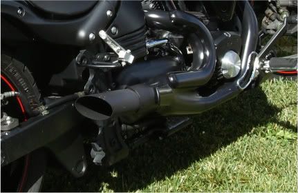

Thiswas a chrometip thatI sanded down andpainted with1700 degree header paint.Follow the directions on the can to"bake" the paint on. I haven'thad a problem with it pealing so far. It doeshave a couple chips in the tip though (dropped allen wrench on it a couple times taking off the rear pegs). This isVERY sturdy and does not vibrate at all. I'veracked up a couple thousand miles with thiswith no problems.If you have anyquestions just give me shout.

lol well it is loud and true doesn't have the great tone as a full set of pipes. Though for only $20 it's a big improvement over stock.
I've rode with this for a little over a year and can't say I've had any flames come out, you must be running pretty rich. Though it would be a pretty cool sight.
