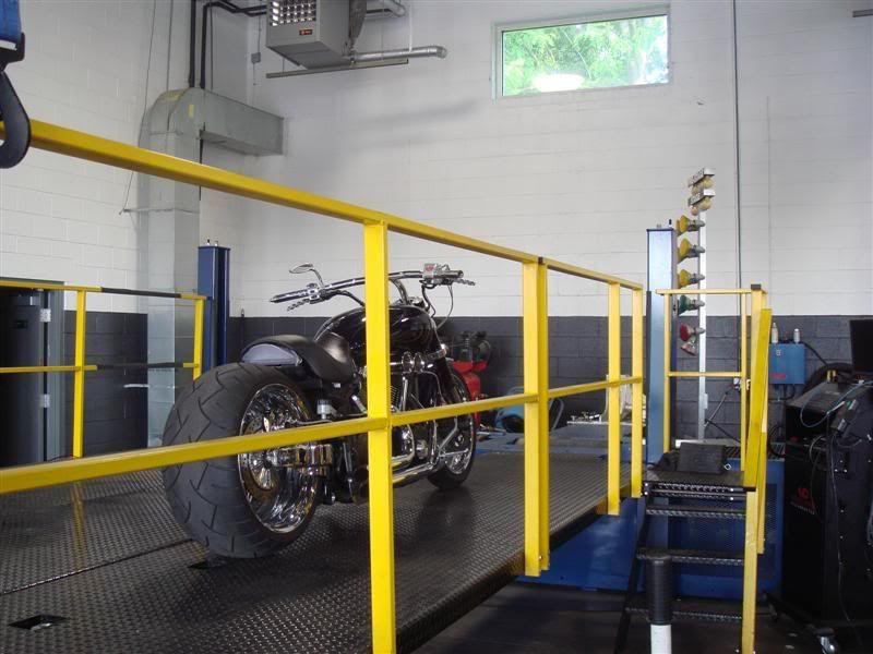

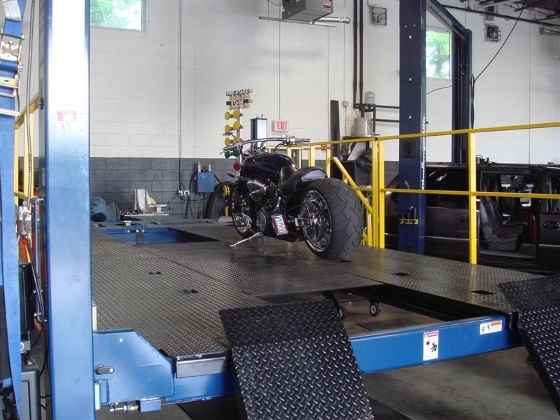

Got to run my bike on our dyno at the shop i work at on saturday. its a mustang 1100 dynomometer. first time we did motorcycles on it. a little trial and error but things squared away fairly quickly. to the rear tire spinning that fat 280 i got 99.2hp and 120.5 ft.lb not too bad i think for a stock motor with pipes, vbak, usb3. let me know if any of you all want to come and run your bikes to see how they do. also we are able to 1/4 mile runs as well. thanks to the other member who we got to help get his bike tuned alot better. sorry i forgot your handle on here, hopefully you'll chime in.

Those power numbers are way exaggerated my friend. I do not know S$%^ about the Dynometer 1100, but no way in **** are those numbers accurate for a stock motor with a 280 on top of it....S$%^ if I lived closer I would be all over that to see 150 hp out of my Warrior. Nice pipe dream[/emoticons/emotion-2.gif].

highest number for bak/pcIII/goodpipes that i heard of were a bit less than 90hp with stock-wheel AND custom map.
your 280 and the pipes should eat power big time and settle it somewhere around 80 to 85hp at the rear wheel.
i'd suggest, you do another run on another dyno /emoticons/emotion-5.gif
or did you spray nitrous into the bak?

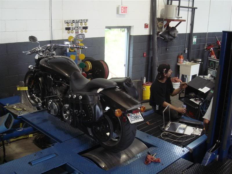

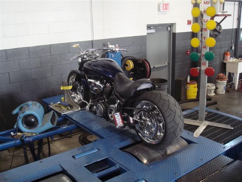

the second warrior pictured has his old dyno sheets and after we ran it there was no more than a 1 ft.lb difference in the two. thats pretty **** accurate if you ask me.

All I am telling you my friend is those numbers are very high and they are exaggerated power #'s for a basically stock Warrior. My Warrior has a total build. 108 Big Bore with HC 10:50.1 pistons, ported heads +2 valves, s*springs, ported exhaust manifolds, s* cams, s*star ecu, vbak, rinehart exhaust system with monster baffles, plus add the slow me down 240 rear tire and you and I are pulling exactly the same power #'s. I am at 100.2 hp & 120.6 ftlbs. it does not take a genius to figure out that something is not quite right, wither it be my numbers or yours, but I would be willing to bet on the the accuracy of my Dyno Tune over your number's......there are plenty of us who have been around this site for quite some time and have seen it all when it comes to the Warrior power #'s. The 280 rear tire, swingarm, rim will suck 6-8 hp out of your engine. This is a fact. So, basically you are telling us if you had a stock rear end on your Warrior you would be pulling 106-108 hp & 126-128 ftlbs.??? Are your numbers's corrected? I highly doubt it.

I totally understand, your #'s are coming from a motorcycle specific dyno, mine are coming from a car dyno that is setup to run bikes on as well. there may be the big difference right there. i'll get to a motorcycle dyno soon and give the update when i do.
