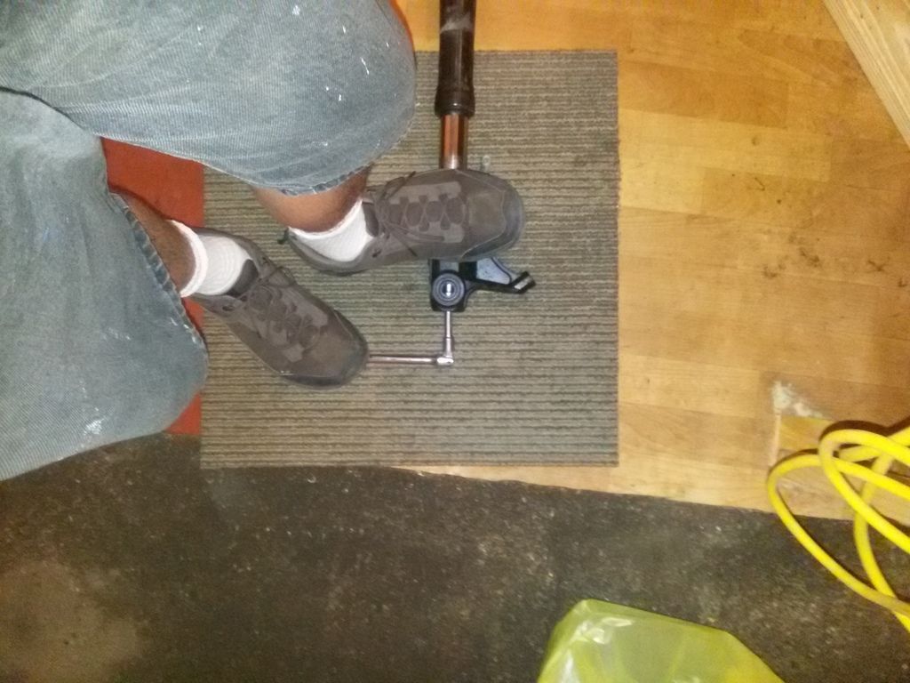

Now you need to break loose the lower tube assembly from the upper. In the bottom of the fork you will see a socket screw down deep in the assembly. It's better to have an air operated tool to break these loose, but I was able to do it on a piece of carpet with the tools shown below.
3/8" Ratchet with 3" extension
10mm Hex Key socket
8) Insert the 10mm hex socket into the hole until you can feel it engage in the bolt thats down there.
Since I didn't have air tools to break loose the socket screw in the bottom of the assembly, I simply laid it on a piece of carpet, placed my foot on the bottom of the assembly (black section) to steady it and simply stepped down quickly with my other foot on the ratchet. It took me a couple tries to get this to work but it eventually did work. It broke loose.
(If this fails take it to a shop where they can simply break it loose for you but don't remove the screw until you're ready to drain the oil.)
9) Next remove the screw, keeping that end upright, and then turn upside down to drain it into an oil pan. You'll need to work the fork assembly up and down to pump out all the oil.

Give you guys props for getting this done without the tools. My 06 forks would not come apart no matter what trick I tried. That bottom Allen just spun the inner shaft.

I got it loose no problem. Getting it tight was an issue. I wish I would of had a new copper crush washer. But I didnt and a few hundred km down the road it starting leaking a bit resulting in a roadside repair.....
8,784 Posts
How do you stop the inner rod assembly from spinning?
If coming from the bottom of the Fork Leg cap screw you'll want to tighten up the fork spring compression adjustment to max. If that doesn't work you'll need an impact or purchase the proper tools and come from the top etcetera ...
110 Posts
Have to come from the top then. Thanks, alanh.
