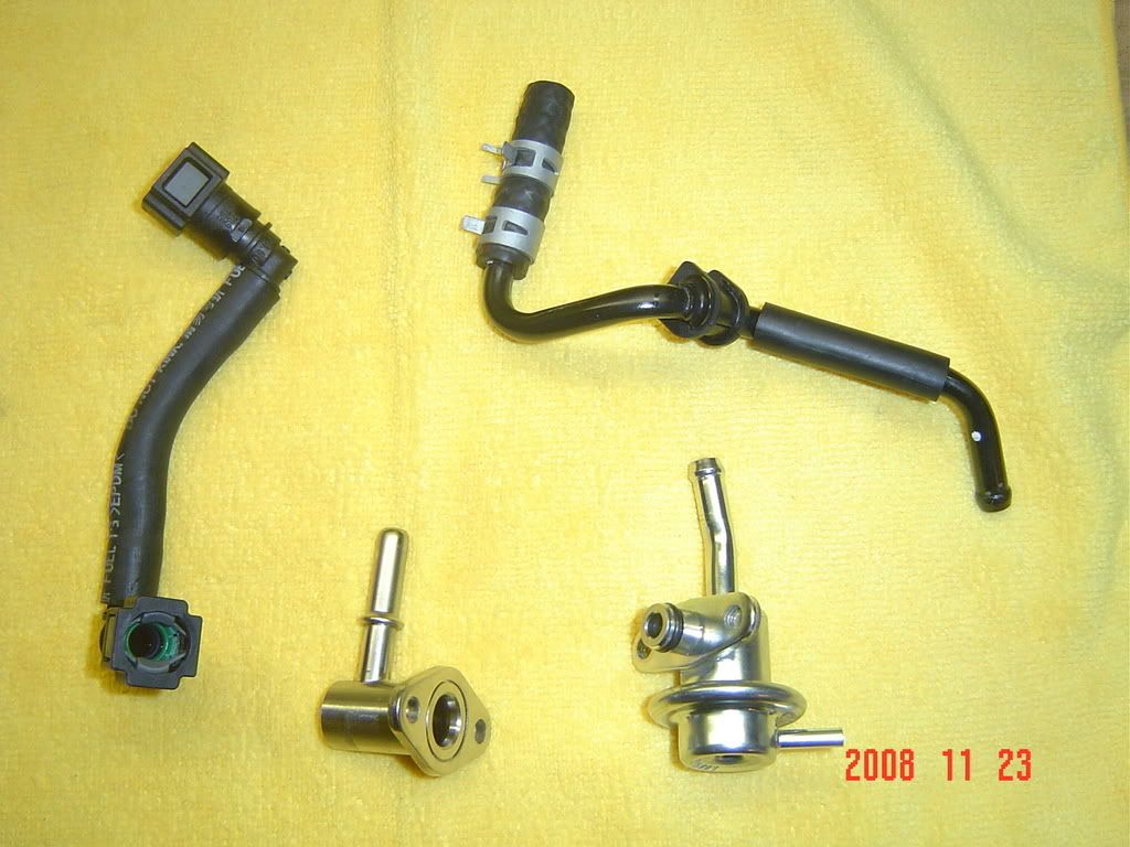

OK, got the left side clean up going. Removed, cut, and painted the bracket. Kinda stuck on the FPR relocation. I tried to move it to different spots but it kinked the hose or was rubbing on something. I read in past threads that I need a 5/16 ID FI line hose and clamp on the high pressure side of the FPR. Here's a pic of what I have off. Which side is the HP side and can someone steer me in the right direction with relocating this to a safe spot. How many FI clamps and how much FI hose do I need? As always, thanks guys.

Hey Ruckus , also make sure the tweo pieces are secured together with two small nuts and bolts before cranking up and riding.

could you please go into detail as to how or where you relocated it? i am in the same boat right now. cleaning up and am stuck as to how to finish.
