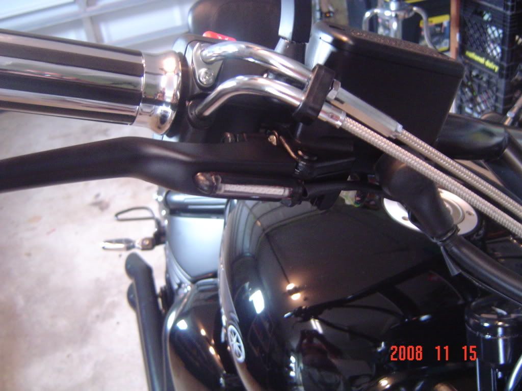

Finally got them on thanks to Steve (patriotins). He came up to my house last night after working all day and helped with my bike until 1 o'clock in the morning! . Great guy! We wired the eclipze modules per instructions. Running lights were very bright, but the turn signals WAY dim. We tried every way possible. Still dim. So, we removed the eclipze modules, wired them, and mounted them to the brake/clutch levers as turn signal only. They look great. Very bright. I cut small strips of painters tape, covered the area just where the lights are, and painted the housing black. Now they don't blind me when they're on. LOL. I'll get another set and mount them on the trees for running lights. Thanks again Steve!Took a pic pictures to actually time when the flasher was on....lol.

That looks sweet. It is the perfect solution for anyone with the integrated tail light. Blinkers on the front of a bike without matching ones in the back, just doesnt look ritght to me. What you did is very stealth, very cool.

Very nice job.I realy like those.I have turns mounted to the bottom of my forks but nobody sees them.I have been looking for something to put higher.I think that is it.Where did you get these,what is the part #,how much did they cost.Thanks .Very nice job with them again.

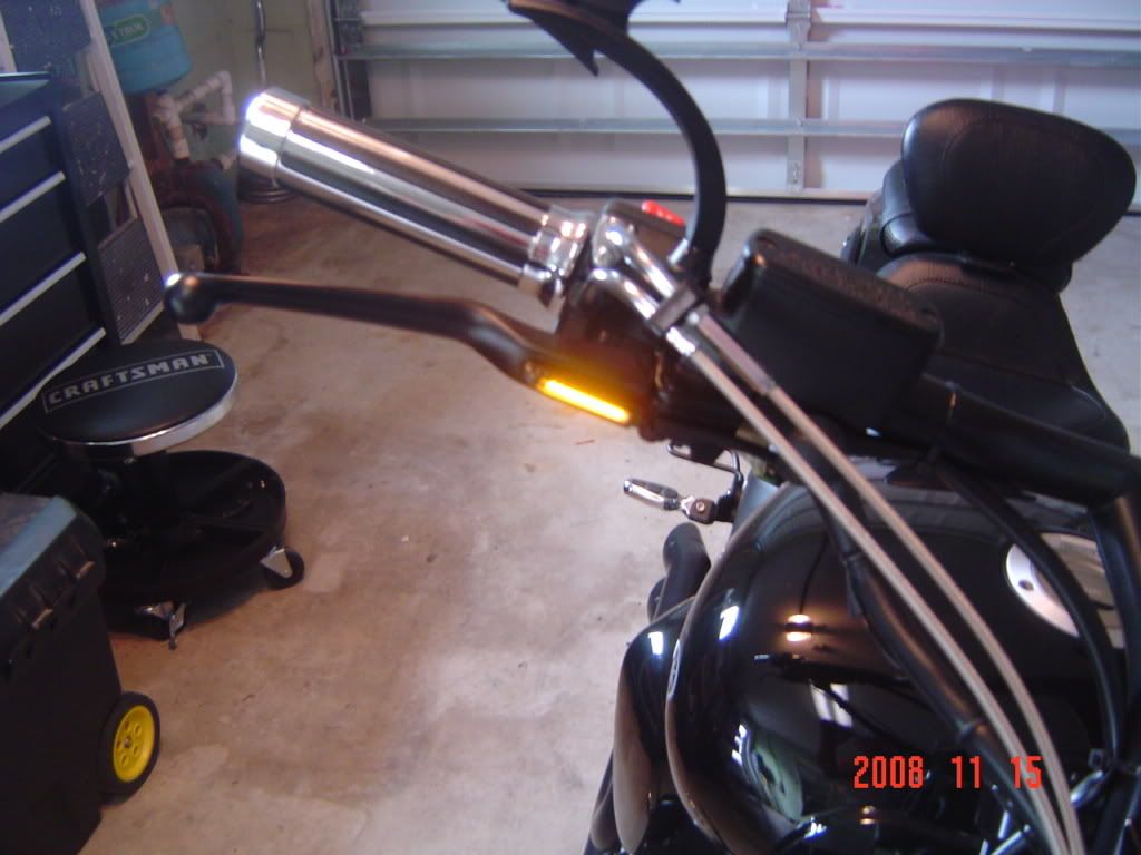

Good news! Now, when you wake up zzzzzzzzzzz, maybe you'll post a pic of the whole front of the bike with one signal flashing and the other side just running light, because I'm interested in this mod!
I'm up....I'm up alread....lol. Here's 2 pics. one running lights, one with right signal flashing. On my way to bike show/rib feast in ST Pete. Thanks again Mike!

So the left running light remains illuminated and the right signal flashes full-on then full-off. Very cool. I hope you will post a complete materials list with part numbers for those of us who might want to take a swing at this with maybe a little lesspain than you've just gone thru! Isn't it nice to be an early adopter?
