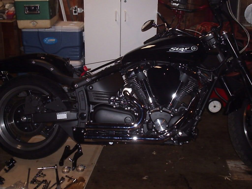

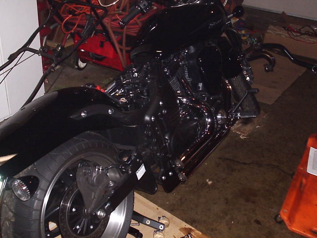

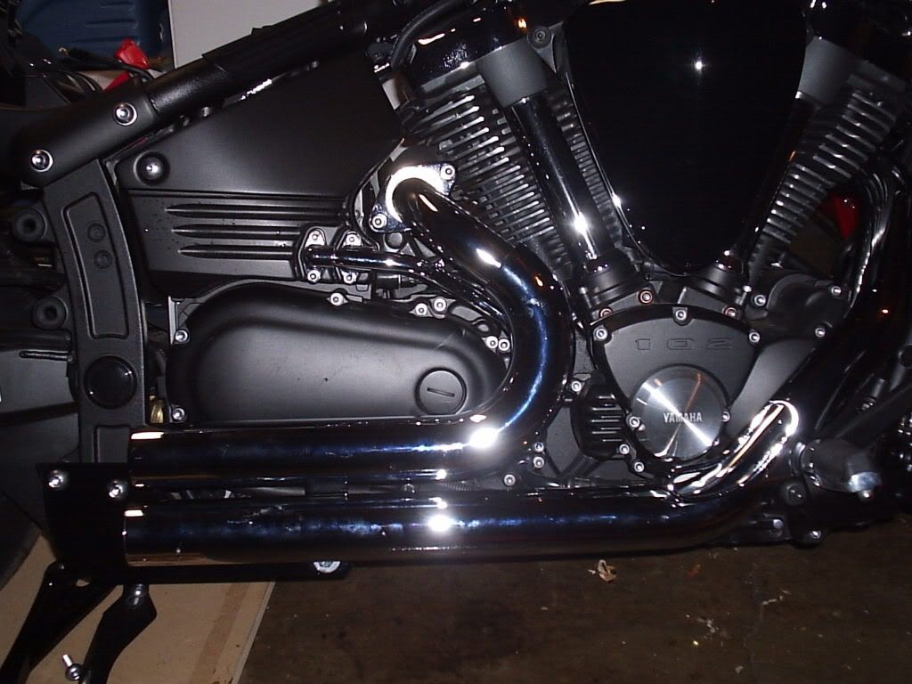

Tonight I decided to get a little dirty and install my street sweepers. The pics arn't very good, because I took them at midnight, and the lighting in my garage isn't very good. But everybody likes pictures, so I figured what the ****. I haven't installed the tips yet, because honestly I can't figure out how. I posted in the technical sectionof the forum about that. I also was unable to completely install my brake reservior relocation bracket because the brake line looks like it needs to be shortened. I'm about to make a post about that. But here are the pics
Yeah, I know it looks like a mess. It is. But it's the dead of winter right now, and I can't ride until April. I have plenty of time to make it all come together. If you have street sweepers please respond to the question I posted in the technical forum. I'm stumped as to how to install the tips

You're missing the heat shield for the top portion of your rear pipe......is that why you ended up with 2 extra band clamps in your other post?

When I installed my streeet sweepers, I put the tips on before I put the heat shields on. I had a hard time getting them on so I used a screw driver to pry them open a little bit. I didn't want to open them up too much so I could still get the clamps on them. Once I had them started on the pipes I used a rubber mallet to get them the rest of way on. Hope that helps.
Yeah, I didn't even realise it until you said it. I'm so frieken pissed. I'm calling samson when I get up on monday to see what they can do.
