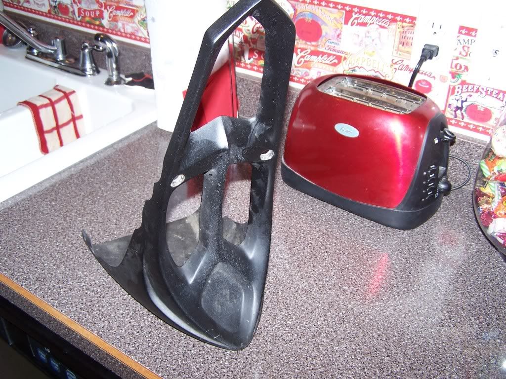

Alright, I started with a matte black, slightly used fairing that I bought from member 1s4255.

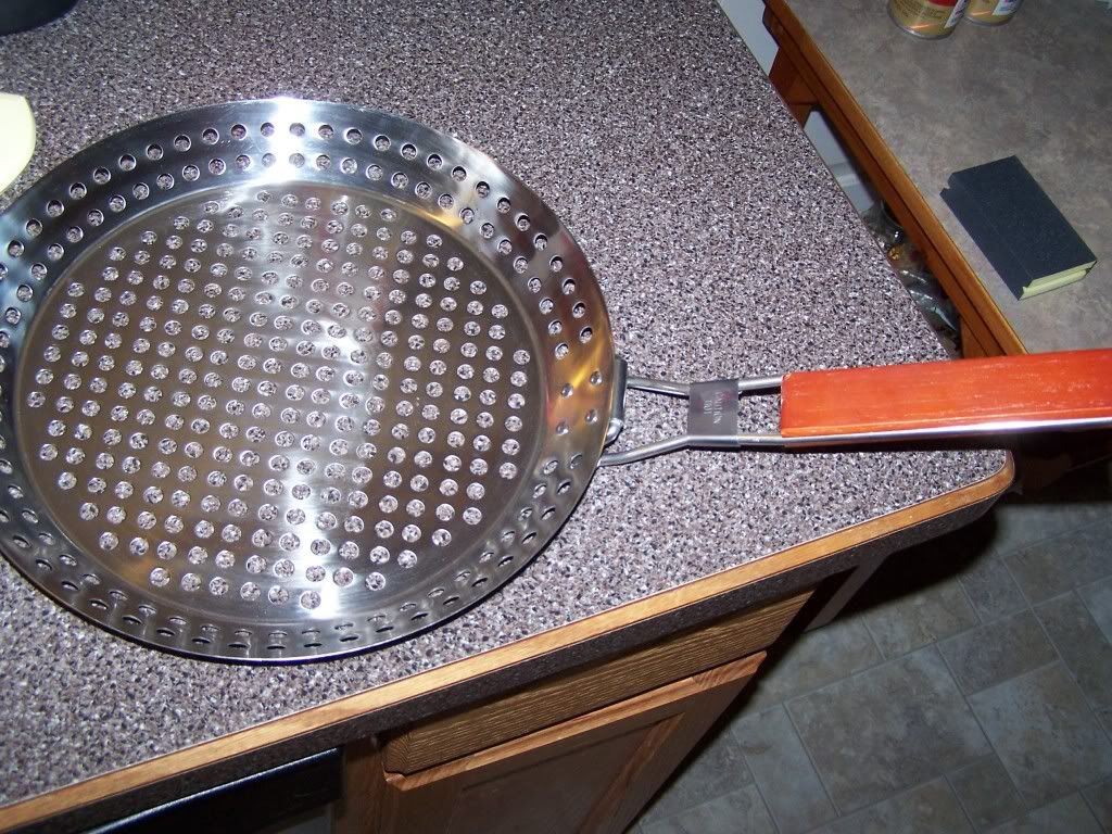

I added 1 chopped up Grill Frying Pan,
And some gloss black paint and some gloss red paint to get this....

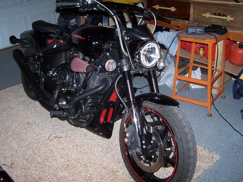

Put the horn inside the Cowl then added it to a Midnight Warrior to come up with this SEXY @$$ BIKE!!!
Now if it would stop FRIGGIN SNOWING I could enjoy a ride with the finished product!

WOW.. bj... that'sthe lovely looking thing!!..and the way you got there 'awesome'..now they'll be a run on grill frying pans [never seen one like that this side of the pond ..about to look all the same!!!] .. amazing how 2 completely different ways of using the L&M [yours and Az] can both look so good!! - very clever - and where did the horn go [as i'm bout to try and copy that!!] - assuming you stuck the grill in?... andassuming that is was a 'stainless' grill pan how did the paint stick so well?

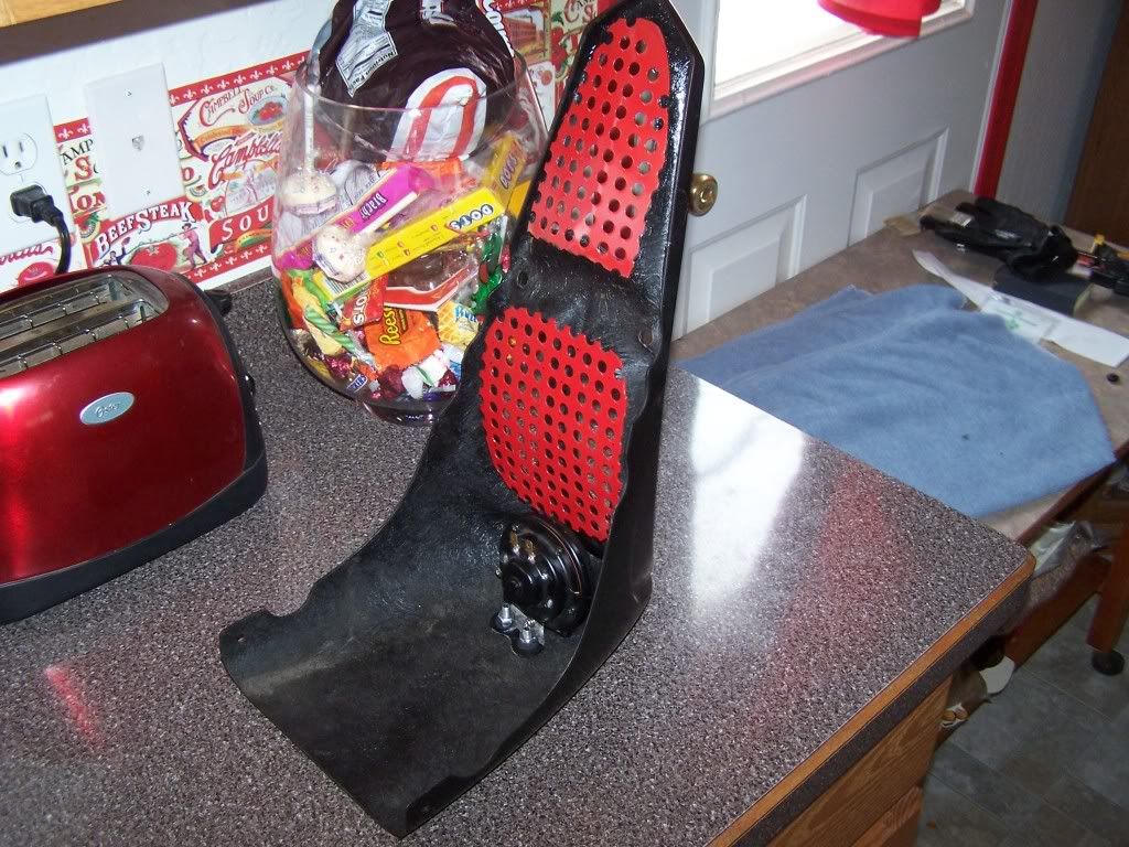

The Low and Mean I got, had the horn relocation holes already drilled and set. The horn is mounted to the bottom "flap" of the fairing right behind the bottom screen. Its a tight fit between the horn and the oil filter but if you angle the horn bracket a little, it fits right in.
To get the paint to stick I used some 220grit sand paper and sanded the fairing and the frying pan. Then I used some new pain that is "univeral" and stick to "everything". I am hoping it lasts a while, we will see. I did 2 coats on the fairing and on the frying pan.
With paint drying time and adhesive drying times, this whole process took about 30 minutes a day for 3 days. Easy to do, really self explanitory, just watching paint dry. lol

No problem man, just a word of advice with the horn, give yourself an extra second to think it through. The brack has to be bent the right way to make everything work right. Then, mount it inside the fairing and immediatly go out and see if it all fits snug. You will more than likely have to re-adjust it. Dont over tighten anything, the fairing will crack. There is no need to though, you can get everything on and snug without being to tough on it.
