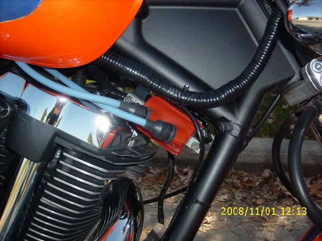

I made my own wires using boots and clips and silicone wire from NAPA. Grand total of $24. You can't see them from the pic, but I did use the stock spark plug boot and put the same size boot as pictured over the top. The stock ones have a screw in post and the silicone wire wouldn't hold tight for some reason so I took a metal plug connector and crimped the ends tight and screwed them on then slid the extra rubber boot over the top of it. I didn't need the zip ties to hold these on but they were too loose for my taste so I used them. I plan on modifying a side bracket for both coils next spring but for the last few weeks of riding that I had this year, I put them underneath the neck using a stretched coil bracket that Bucky gave me.

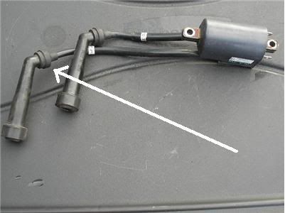

Mike, Woody is right. We can use the 45degrees on the spark plugs and straights on coils:
I'm glad I ordered also the cheap DW800 kit so I can use the straight rubbers on coils.

8,318 Posts
Found a pic
30,076 Posts
370 Posts
This is where I was talking about. If you pull the littlerubber boot up, the wire threads onto a brass stud coming out of the spark plug boot but if you use silicone wire it doesn't want to thread on there very good. I reused the little boots and put these on the end of the wire.......
Then the ends that are open I carefully folded over and made it tight enough that they would thread perfectly over the brass thread and go down inside the spark plug boot and pulled the little rubber boots back down over and they looked like they did stock. Plus they were bulletproof. With the metal clips threaded onto the spark plug boot they wouldn't budge even if you pulled hard.
Hope this gives you some more insight, I'm not always the greatest at 'splainin.

Don't know why you want 45* boots as straight boots work just fine, check the pic I posted.
Suggest thecircle file for the stock screw on plug ends they have a resistor in them.
