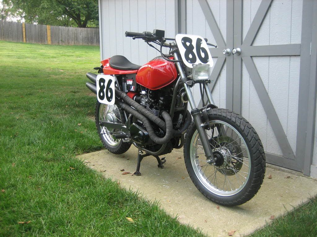

I built a street tracker a while back and it doesn't have a front fender. I expected to get a lot of crap in my face, but I have a full face helmet and honestly haven't noticed much if any change. the bigger problem is the short rear fender. When I hit a puddle, I get a wet stripe up my back. Yuck!
As for the front brake lines, you need the excess. When you hit the gas, the front end rises, the forks extend and the slack is taken up. Without the extra length, you'll tear the hoses out of the fittings. Bad.
