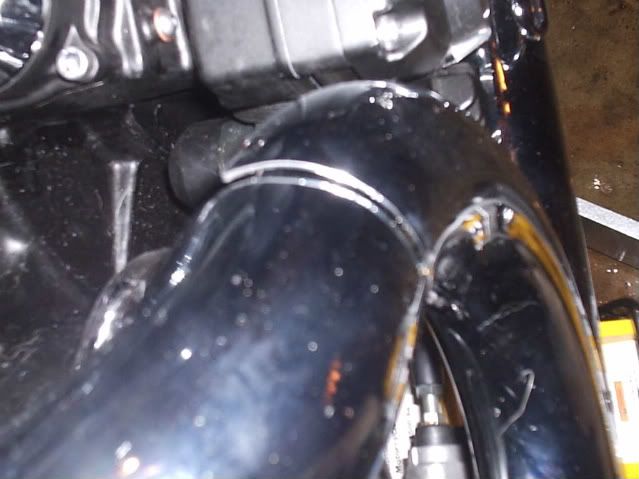

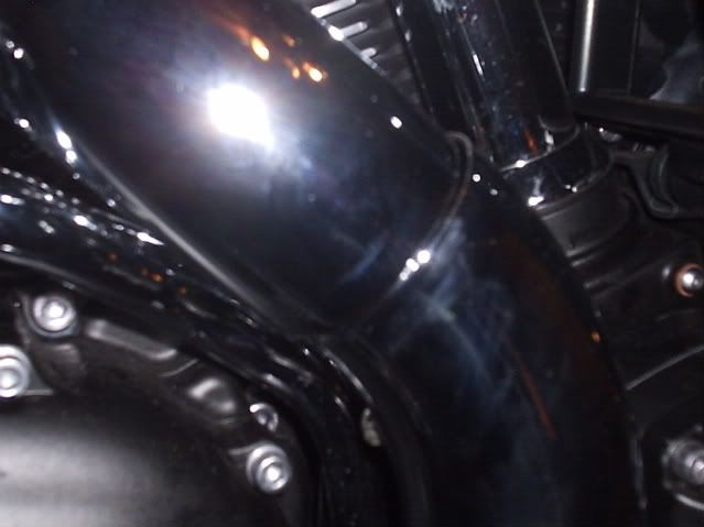

Samson sent me my missing heat shield for the rear pipe. I got around to installing it today, but I've ran into a problem. No matter how I adjust the two heat shields I can not get them to butt up against eachother cleanly. There is a gap. Is this the way it's sopposed to be? If not, anybody want to give me some tips on getting it right? Here are a couple photos
I've been beating my brains out over this so if you can help I'd appreciate it.,,,,,

You'll need to rotate the top heatshield towards the front of the bike. They should look something like this:
There will probably be a slight imperfection in the alignment when you're done, but not noticeable enough to draw the eye, unless you're looking for it.

Ok, now that I know there is sopposed to be a slight imperfection I feel better. I was beginning to think the piece was cut wrong. The pieces are sopposed to butt up against eachother right? No overlap? I asked about this before, and somebody told me that they butt end to end, but I tried it every way possible. I even went to the extent of taking the pipe off the bike and flipping the upper shield upside down. I just can't seem to get rid of the gap no matter what I do.

That bottom shield goes where it goes because of the u shaped bend. The top one is the one to rotate until it lines up. It won't be perfect, but there shouldn't be a gap. They do butt end to end, no overlap.
