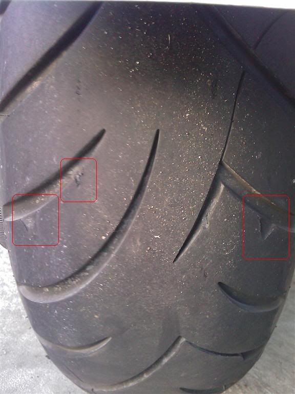

Hi guys,
I got these tires in the spring. I noticed these chips coming off of the back tire. they are Avon Storms, what do you think? Anyone seen this before? Should I go back to the dealer and get them to replace it?
Thanks, Brad.

I would agree with garnerwarrior.....I have the storms too, love em, but I bottomed out a few times and got the same sort of 'cuts' in it. I ahve the RAM396 lowering kit, so I raised it a half turn and no more problems....

I cut the extra length of the bolts havent had an issue since 18,000 miles 6 tires later
garnerwarrior said:
Looks like you are bottoming out are you? if so raise the rear! Sure looks like the fender bolts are cutting your tire

Discussion Starter · #5 ·
I think you are right, the inner marks are caused by the bolts. Great suggestion. But, the chips... i am sure that is not the fender or bolts, if it was, the chips would be on the other side of the tread groove.

To make sure, just roll the tire and see if the chips line up with the bolts or any other structure inside your fender.

Hi guys, I got these tires in the spring. I noticed these chips coming off of the back tire. they are Avon Storms, what do you think? Anyone seen this before? Should I go back to the dealer and get them to replace it? Thanks, Brad.
I can guarantee you that you'rebottoming out on the leading edge of the inner fender very badly
... that's not from the seat tail hookor fender stay bolts and you can BANK ON IT!
Take alook underneath the fender and you might find the missing pc's
... the finger print from the collision will probablybe visible... this type of occurrence will eventually lead to a bent rear axle IMO
The Warrior rear suspension was designed to bottom out on the urethane stop bushing on the mono-shock and not the inner fender

Yeah, you guys are right. I took off the pillion seat, put bolts in to fill the holes. Now i have cut them off. Hopefully that'll help. it will still bottom out, but the bolts are gone. Funny, the battleaxes never did that.

****, it is hitting the inner fender.
This bike had been lowered when i got it. It is a pita. now what? 1000lb spring? or un-lower the beast? I assume the linkage was swapped out to lower it. where do i get stock linkage? The dealership I guess.

If you like the lowered look you can get adjustable links from "ram396". That wasy you can raise enough to clear but still have a lowered look. Another thing I'd do is adjust the preload on the susupension spring to a firmer setting. If it's already adjusted near max, get a Eibach 1000# spring.

... the Eibach 1000# spring will compliment the lowered suspension but as i stated earlier, it doesn't guarantee that it won't happen again. If you're running a stock rear tire it's less likely to reoccur with the heavier springIMO.
