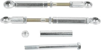

There are basically 4 types of lowering methods. The first and most expensive is an air suspension which allows you to raise and lower your bike and generally there is around 4 to 5 inches of travel. The most popular for the Warrior is the TAS or Tricky air suspension.
the second method is a flip and grind. If you search flip and grind you will see how this is done and it lowers your warrior a specific amount ( sorry not sure the amount) and the bike always remains in this position and is not adjustable.
the third method is to get a lowering kit.The most popular are Barons or PCS which also lower your bike a specific amount and are non adjustable. These kits give you new links which lower the rear of the bike when you replace your stock links. they usually lower your rear around 1.5 inches. Usually most members when they go with this method or the next method swap out the stock spring for a heavier spring rate or a progressive spring rate.
the fourth and probably most recommendable for someone who does not want to shell out a lot of $$$ for air is adjustable links. This kits also swap out your stock links but give you adjustable links so that you can adjust the amount of lowering so for instance if you lower 2 inches for solo riding if a passenger seems to be too much then you can adjust them to raise the bike a bit more.
These kits basically lower the rear of your bike. they do not lower the front and as such will give your bike a different stance. you can also get raked fork trees either 6 or 7 degree which will lower the front of your bike. You could also probably loosen the fork clamps and raise your forks somewhat in the trees however you need to be very careful doing this as if you raise your forks in your trees the travel between the neck and the front fender is reduced and if reduced too much it could cause an accident if you hit a big bump

IMO avoid the flip-and-grind. Removing a bit too much material results in a broken link at some inconvenient point in the future. But if you do it anyway, there's a pic in the Documentation forum showing an example. Even doing a flip-grind as 'right' as known possible its still less strong than it was and is not height-adjustable so you are stuck with where it is.
Barons / LA Choppers / PCS / Soupys all have good quality manually-adjustable links. The eBay and CL links are actually often very cheap hardware and you probably don't want that under your butt at-speed. Its a good idea to buy what ever brand you want but buy from a known supplier/seller.

I don't know what brand they are, but they are black and I meassure 11 21/32" center to center. That should lower it about 1 1/2".
#15 ·
I think the stock dogbone length is something like 289 or 290 mm or about 11-3/8". Making the dogbones longer drops the rear. There's a couple threads/posts around here with dimensional info (related to adjustable links and number of turns to achieve a dogbone length in order to drop the bike a desired amount). These bones are 11-21/32" or about ~17 mm longer. Have to run so cannot do the math but the OP's data could be right. Figured I'd post this in case helpful.

Brizzman, aren't those the LA Choppers links?
Stock length links 11 5/16"
LA Choppers/PCS/BARONS length links 11 21/32"
3/8" longer then stock. The links will drop is to drop the bike about 1 3/4".
