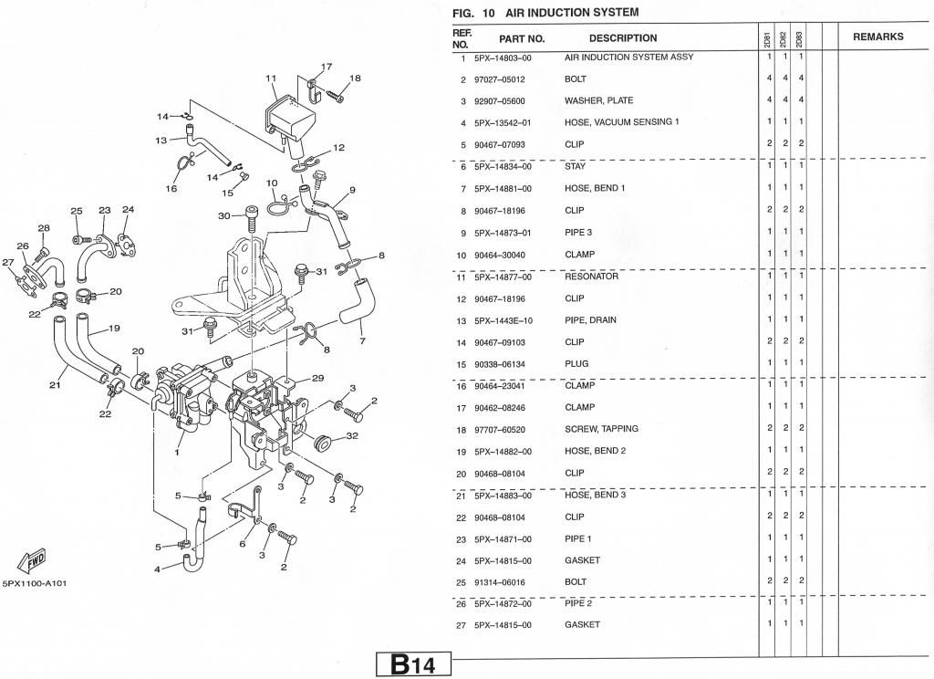

BlueBlood, did you remove the pipe? (parts 23 and 26 in the picture)
It sounded like you left them on and capped them, I could be wrong....If you did, I would move over to what the rest of us have done (make or buy plates to cover the opening at the cylinder..I used the gaskets already there (24 and 27) and made simple plates to fit. Below this picture is a link to the Barons kit for ~25 bucks....
Let us know if you have plates or the pipe capped....you have an elusive problem so we have to be as thorough as we can. Doubt that would cause a problem but...............
Barons block off plates:
http://www.baronscustom.com/catalog/display/526/index.html

No pipes. I followed the AIS instructions to the T. That was done over a year ago, and no problems since. The most recent motor changes include VBAK, Dyna coils (and relocate), plugs, and LCV delete. Everything else was cosmetic.

I'd say double check the AIS blockoff bolts and gaskets, then check the T/B's against the head. Also make sure that the Vbak downtubes are sealed up and lined up correctly.
