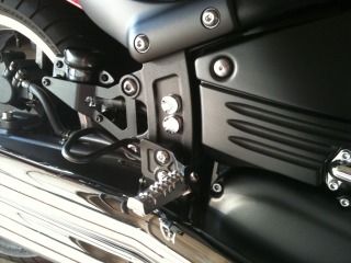

Probably been done before, but the biggest complaint riding two up is the height of the passenger pegs (to high).
Quick trip to Ace Hardware for some chrome bolts, chrome caps, a tap and stainless bolts to go back into the stock mount locations (with the chrome caps) is all it takes.
30 minutes later and you've got a tasteful looking mod that lowers the passenger pegs a full 2 1/2".
